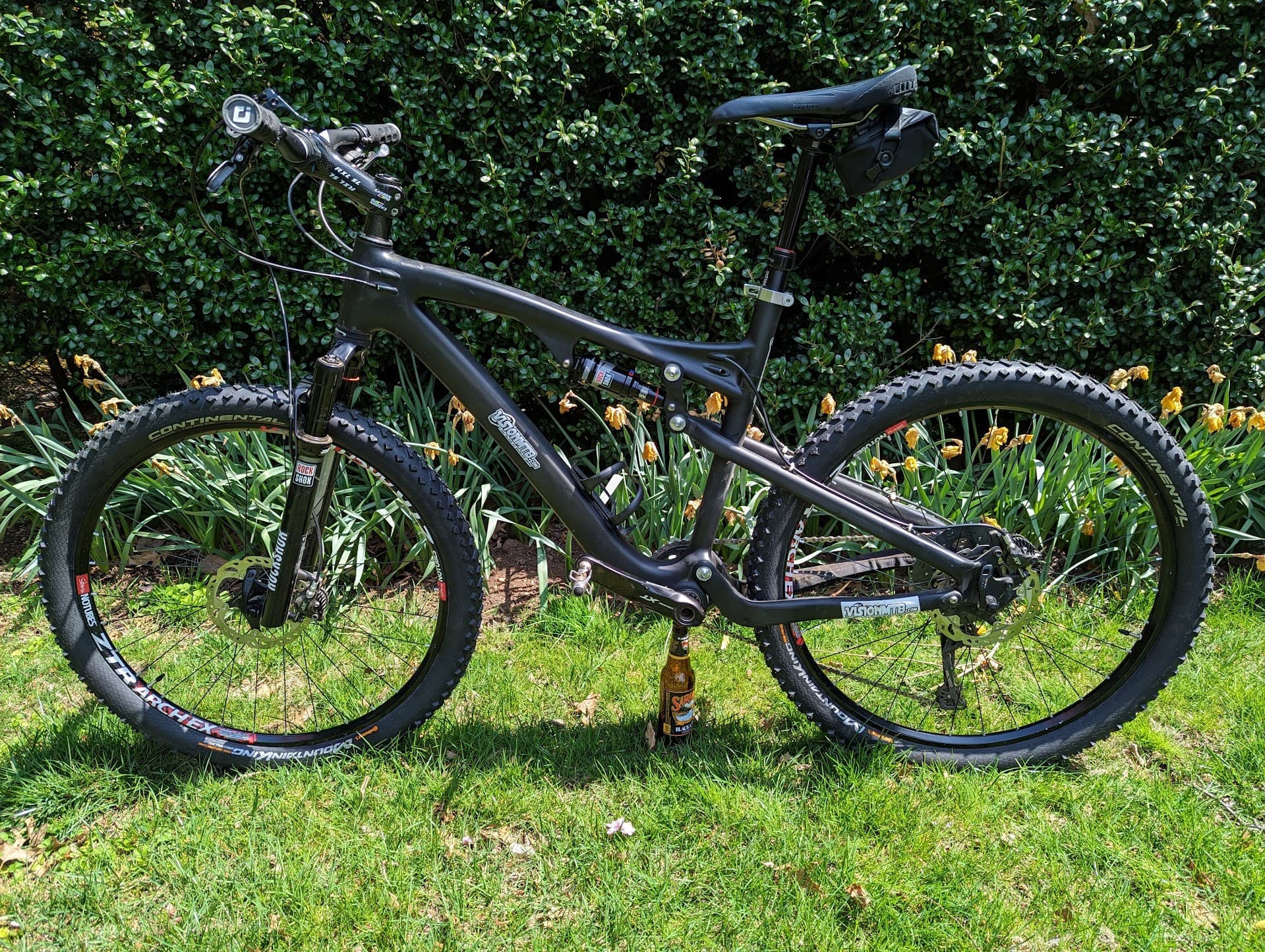

Let me run down my situation. Running an 8 year old 26" carbon full-squish XC type of set-up. Nothing really wrong with the bike - it’s just not so perfect anymore. While very light (25lbs), it’s also limited in travel up front and in the rear. There’s also the 26" wheels that make everything kind of jittery when riding. The upside is there are some parts on here I can use! Maybe.
