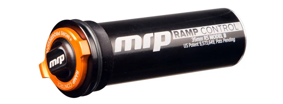

I’m working on the suspension to see if I can’t fine tune it more accurately and easily with a Quarq Shockwiz and in preparation of hooking it up to the Yari fork I bought an MRP Ramp Control Cartridge. I’ll let you know how it goes once I get it in there and start testing.

Now the fork oil viscosity can be messed with but the air volume in the damper cant. Which leads me to wonder how this does that.
There must be a some sort of way where the knob is turned and a plug is moved up and down the control body to change volume.
