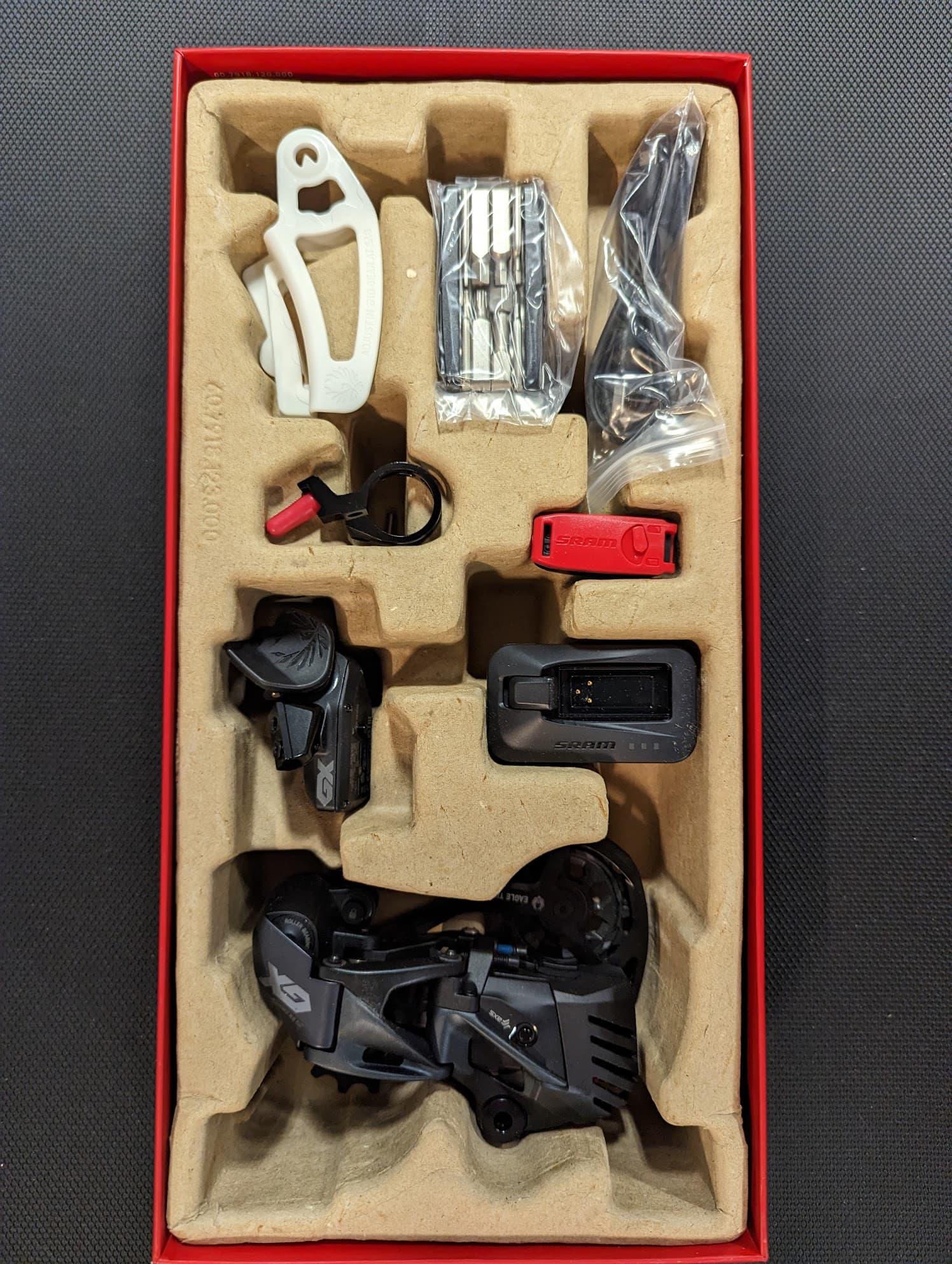

So... SRAM AXS GX upgrade kit
Yep, I went and did it. I’m still dialing it in and have not been on the trail yet but so far, so good. Straight up Shimano XT everywhere but the rear derailleur.

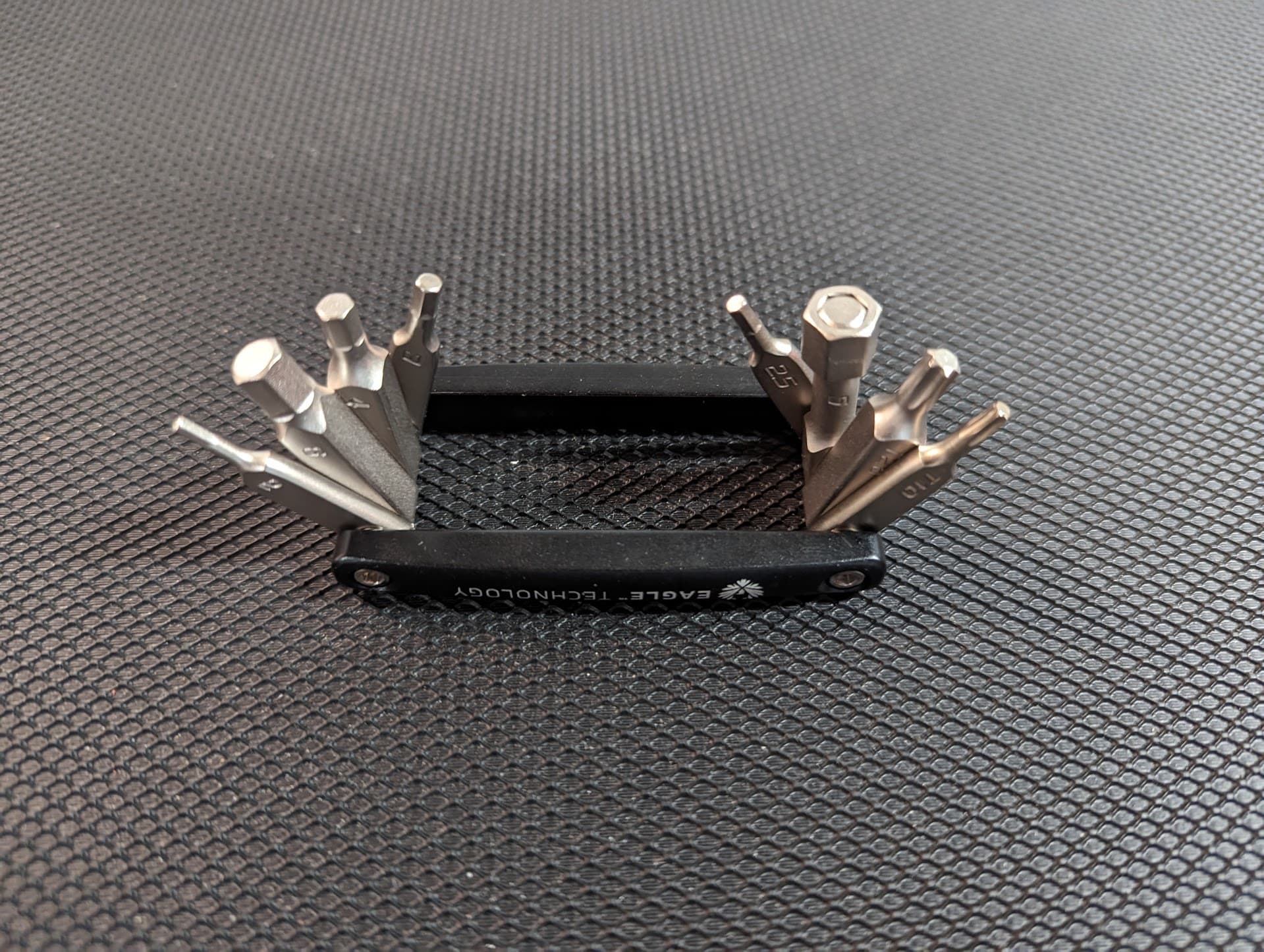

I forgot to mention the box comes with a nice little multitool.
