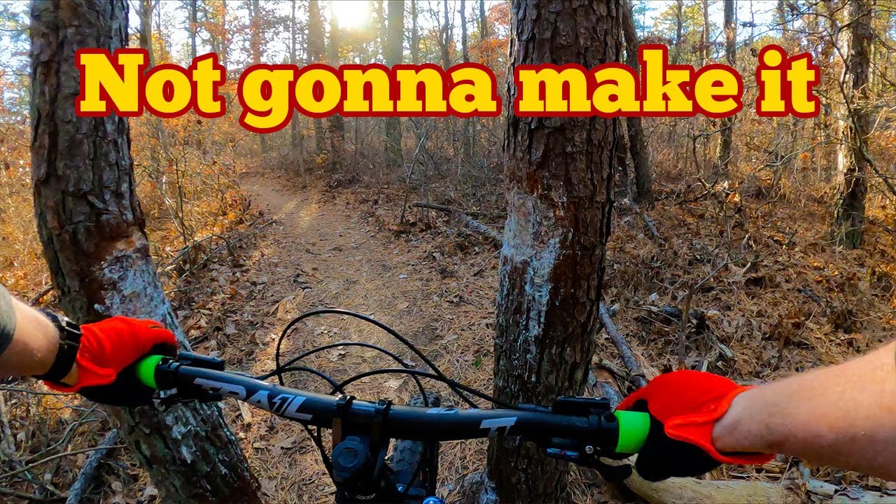

When leaning thru turns the trees become tighter and I need more room and this is why I use
685 mm wide bars. On my Dirt bikes I have always been at 32 inches (812mm) and I do not feel I need that type of leverage on a 25lbs bicycle.
On my new bikes I run a 75mm stem with 685 mm bars
The front-weight gain from a longer stem is real, but it also lengthens the steering lever and can make the front feel less planted at speed; that trade-off may explain scrub tendencies as much as bar width. At 685 mm you’re giving up some leverage, which suits quick lean transitions but can feel twitchy in rough terrain. If cornering bite is the goal, adjust stem length and bar width together rather than chasing one number.
